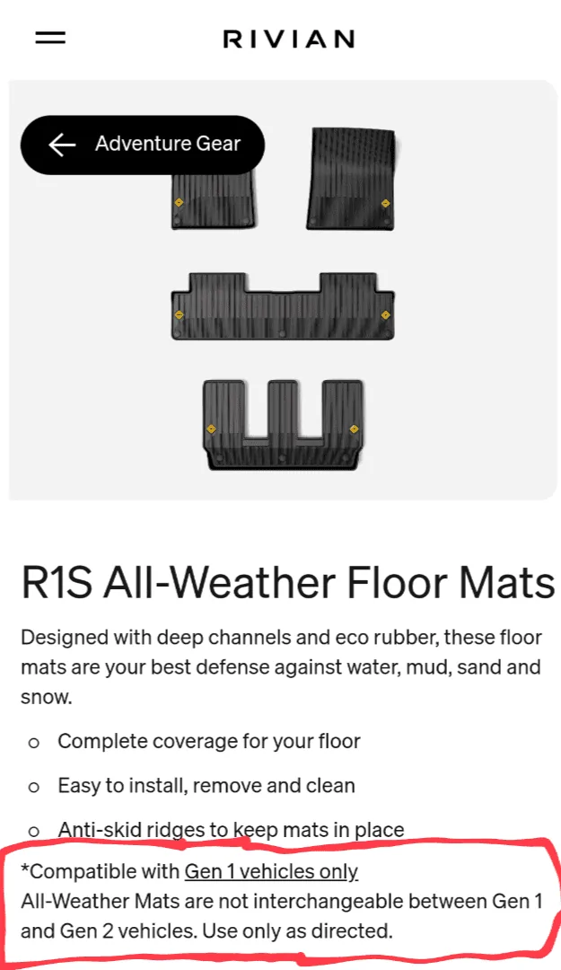

We quickly got on the highway after delivery and... well... I floored the accelerator... as one does with a very powerful vehicle. The accelerator got stuck behind the mat and the car quickly accelerated unintentionally. Thankfully the break overrides the accelerator so I quickly brought the vehicle to a stop on the shoulder. We replaced the mat with the carpet one and everything was fine. Other than a moment of high stress.

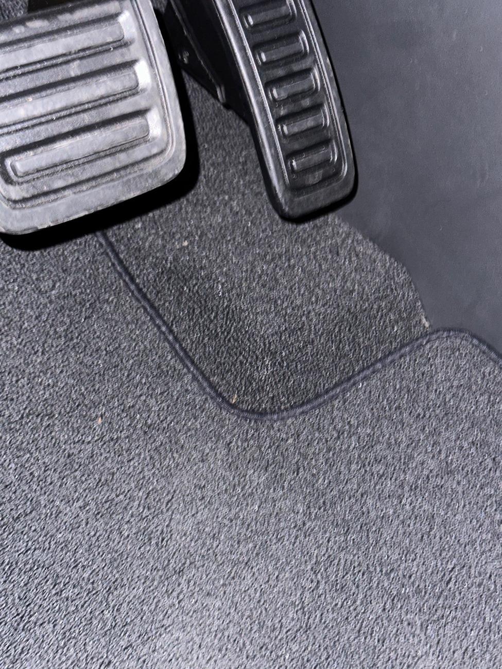

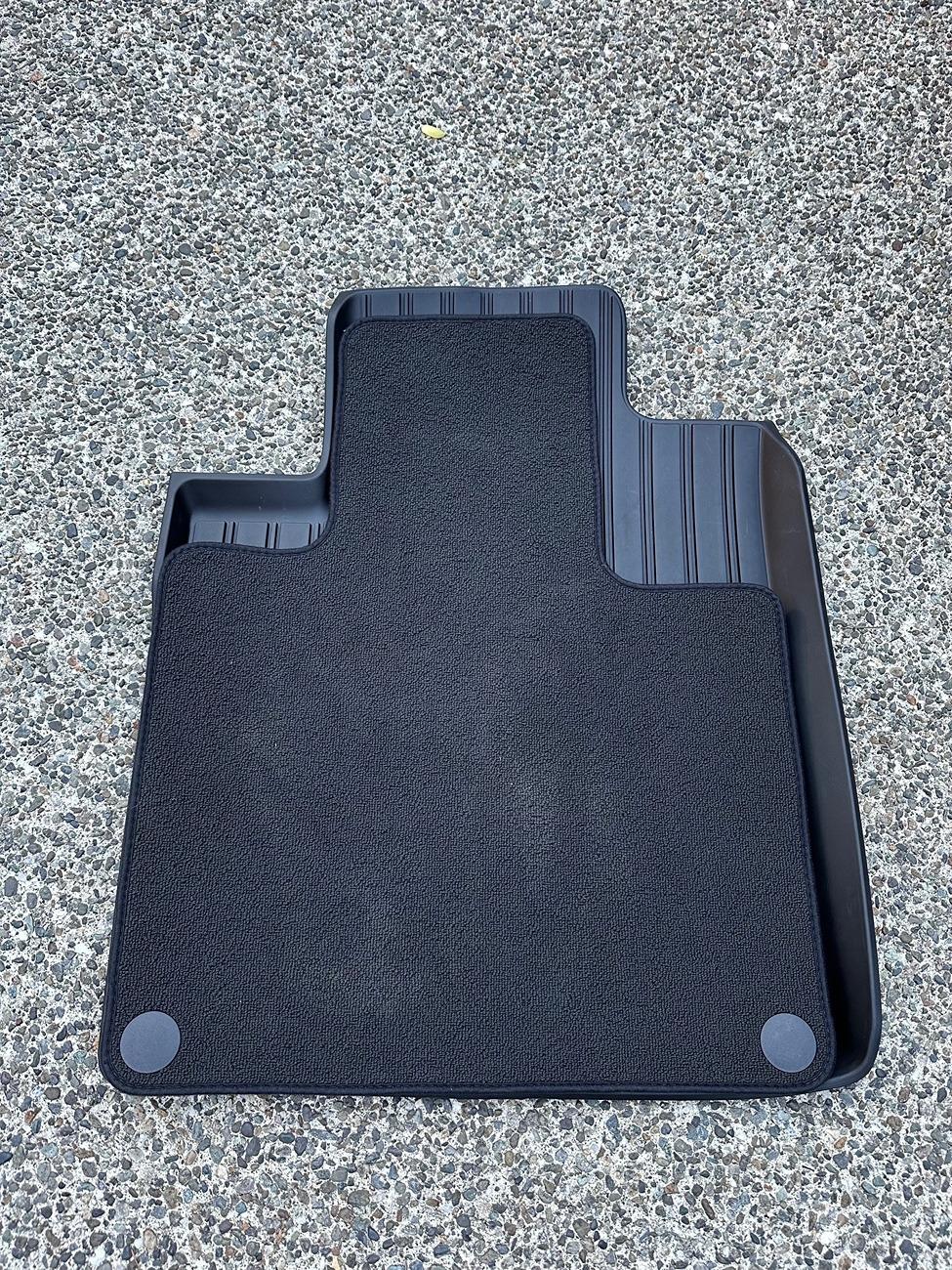

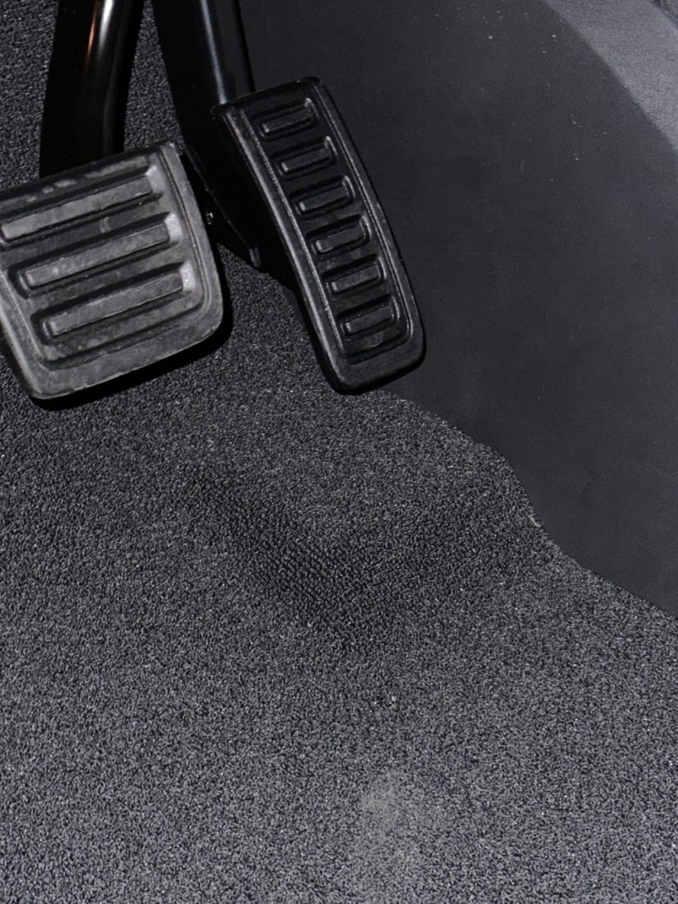

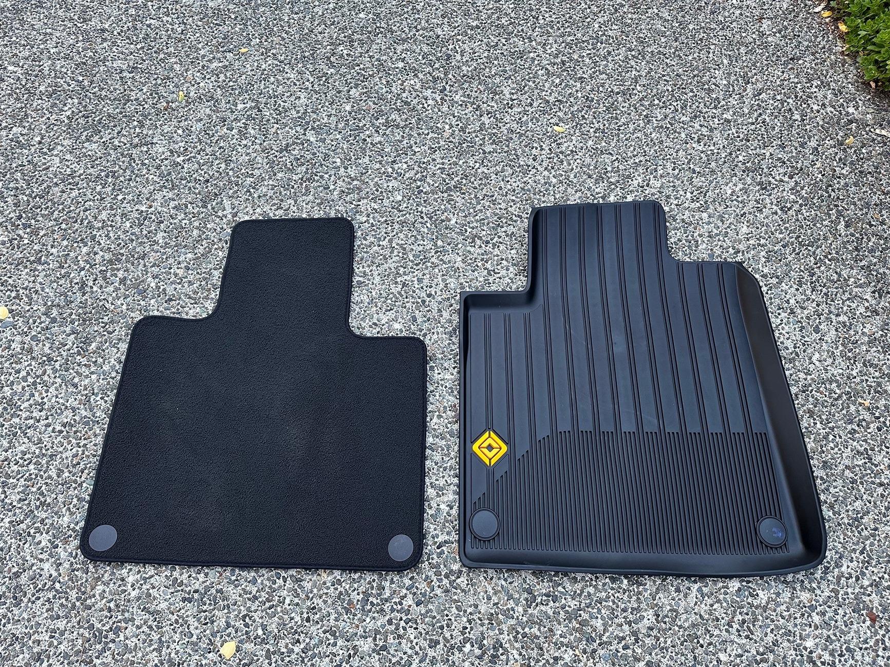

So here's what happened. The Gen2, has a small bump on the floor right in front of the accelerator. The mat was correctly installed but it's not of the right size for the Gen2. The carpet mat is smaller to avoid the bump on the floor. The all-weather mat on the other hand, does not sit flush on the floor because of the bump so it's raised by an inch or two on the side of the accelerator. If one floors the accelerator, it can get stuck behind the raised portion of the mat.
For now, avoid using the All-weather mats on the driver's side.

They should have put the Gen 2 posts (to snap the floormat in) in a different location - so it would be impossible to properly install Gen 1 floor matts in a Gen 2 vehicle. With a simple (buried) disclaimer, this is far to easy to make this mistake.

If you decide to keep the all weather mats, perhaps you can cut and trim the section that is near the accelerator pedal. Or sell them and get Gen2 mats. Cheers
Since they were part of the purchase of the truck Rivian just needs to replace them with the proper version, without any additional costs.
Or update the all-weather mat to be cross-compatible. I'm surprised they didn't do this but keeping the posts in the same place seems to indicate that may have been the intention. Then they could have flushed out the old design prior to Gen2 launch.
