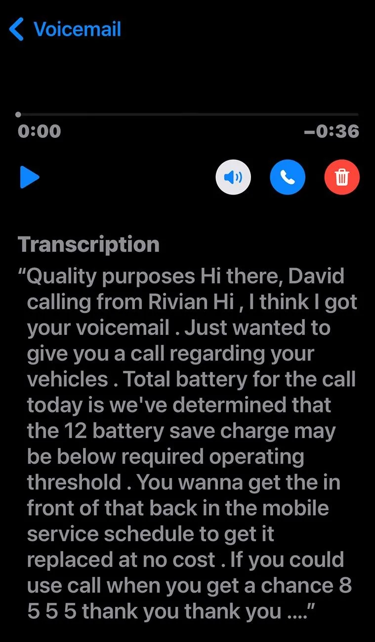

Got a call today from Rivian service out of the blue telling me that my 12v battery charge was getting low and needs to be replaced. Has anyone else gotten call like this? I looked all over and can’t see anywhere I can check on the battery levels in the car UI or the app.
I called back and got a mobile service appointment for the 30th. Soonest they had available. Interesting that they proactively monitored for it and notified me.
Show full message

Battery replaced successfully. Took about an hour. He didn’t share too much information that hasn’t already been said in the forums, but alluded to there needing someone dedicated to rooting through all the data to find the vehicles with 12v issues based on the data trends. Guess I’m glad they caught mine before it bricked randomly.
Was able to get them to force the software update so I get at least 1 day to enjoy the car costumes. Really well executed in my opinion.

I just got called yesterday to schedule for Thursday this week to replace mine. They said they're moving through a list of VINs and being proactive. I am assuming its from a potentially bad batch from the manufacture?
ThumprMN
ThumprMN
That’s what I was told.
